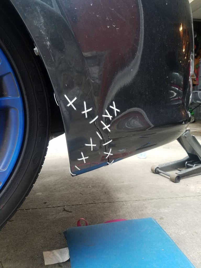

    First take your bumper pieces and line them up, hopefully they snap or fit together decently.
    Next place a strip of duck tape along the whole fracture line. (Bad Photoshop but the tape doubles for paint protection while drilling and it'll clearly show the fracture line when drilling for ease)

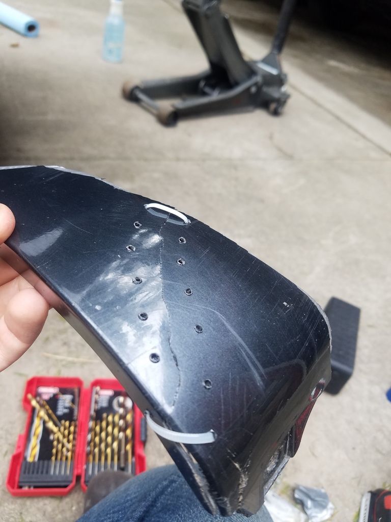

    Drill your Zip-Tie holes in any fashion you'd like but I did the typical zig-zag pattern. (Again bad photoshop)

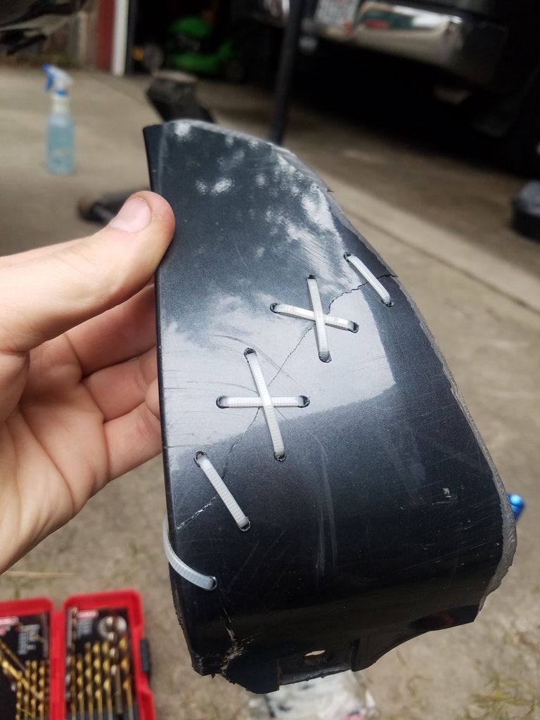

    After drilling, remove the duck tape and apply two Zip-Ties (Top and Bottom) to help secure the pieces while you stitch it up.
    After the two stabilizer Zip-Ties are on, go ahead and apply the remaining stiches to complete this piece.

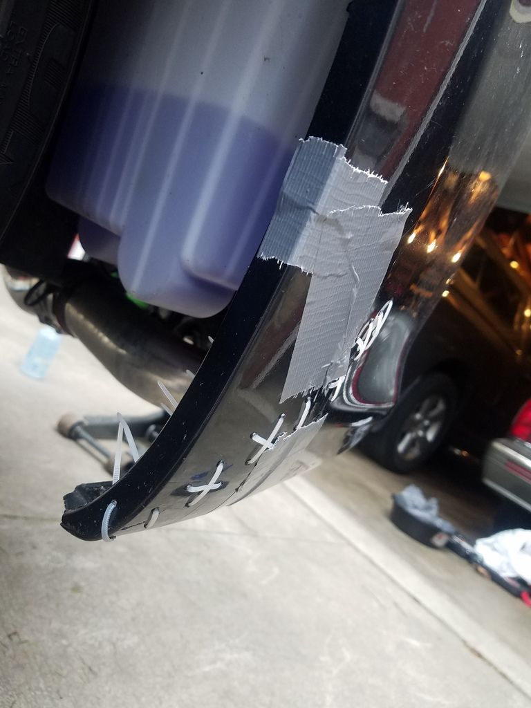

    Next we're going to take this now single piece and line it up to the original bumper to approximate the next stitch job.
    Apply a nice duck tape strip again to approximate the areas for drilling.
    Drill the holes again and remove the tape when done. Hold up the piece and begin stitching. Here is the end result.
    This stitch job has held up quite nicely since then. Still intact even after fighting against all the elements.
