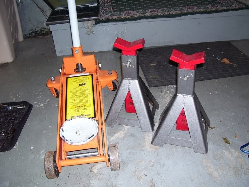

    Heavy tools needed:
    -Floor Jack
    -Jack stands
    -wheel chuck

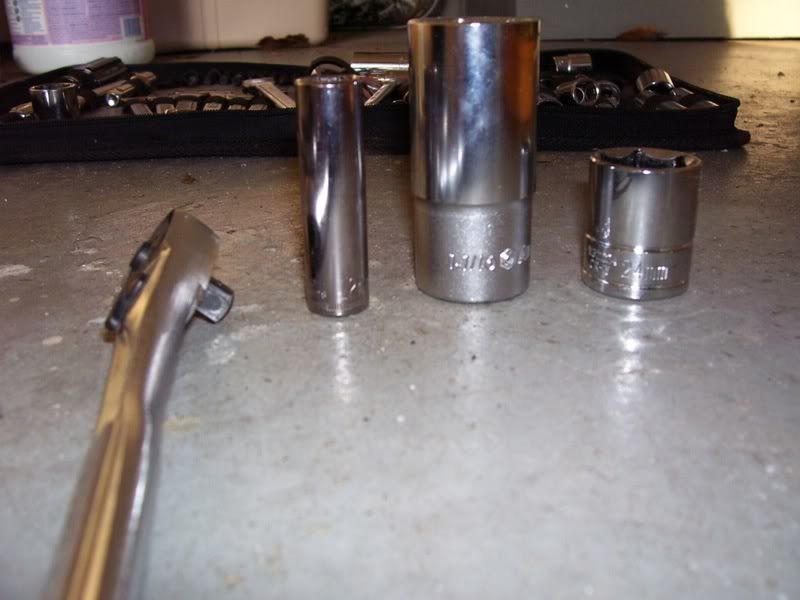

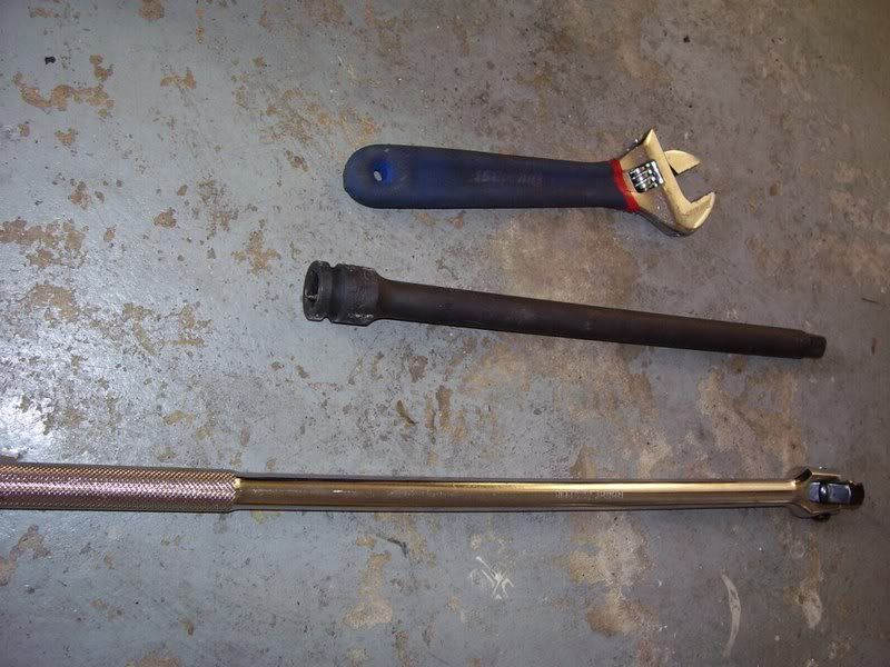

    Hand tools needed:
    -3/8" drive ratchet
    -12 mm deep socket (a 6" extension isn't shown but also recommended)
    -1/2" drive breaker bar
    -1/2" drive 10" extension
    -1 1/16" deep socket
    -1/2" drive 24 mm short socket

    3)Lift car until you can fit jackstands under the car

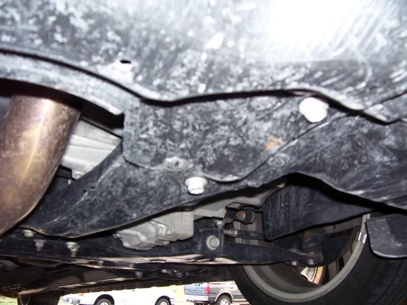

    *I used this flat spot but you can use the lateral rail just past it (it's the square rail that looks about 1.5" thick)
    4)Lower the car a bit so that it sits flat on the jack stands and the floor jack still has a bit of pressure pushing up on the mount

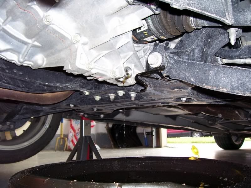

    8 )Now get under the car and locate the drain plug. Plug is in red circle.....green is the fill plug but that's doing it the hard way with a syphon so don't pay attention to that
    9)Use the 24 mm socket and the 1/2" drive breaker bar (if your socket is 1/2" drive) and loosen/remove this bolt. This WILL be messy so make sure you have your oil catch can under neath it.
    Try to hold the bolt in place as the fluid comes out until a good bit has drained. This will prevent it from going everywhere.
    Just let it drain for about 5 minutes.
    10)When it's done draining, replace the drain plug and tighten a good bit. It has an aluminum washer so it'll feel like it can keep tightening but just go until you feel it's very snug.

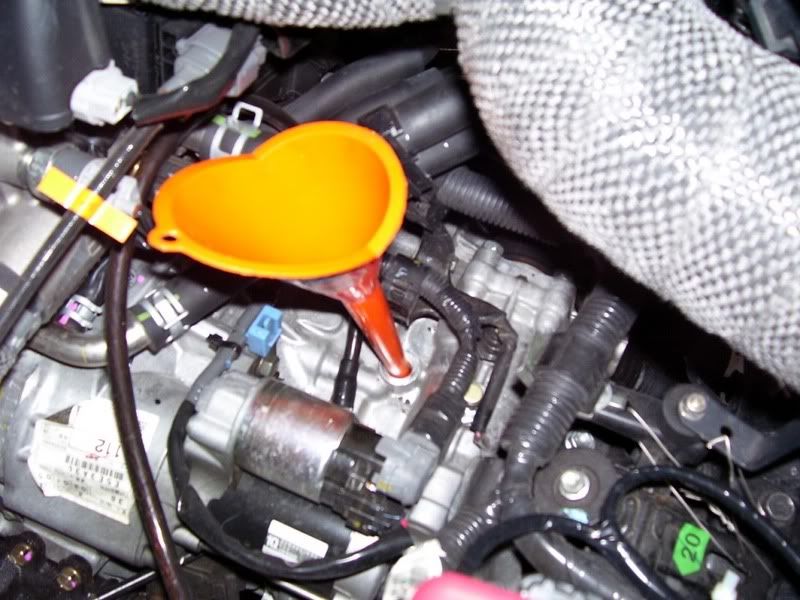

    12)With car on the ground, grab your funnel and place it in the hole where the reverse sensor would go.
    13)Add 2.5 quarts of your desired gear oil. You can use Redline MT90, Amsoil 75W/90 gear oil,...Just make sure it's GL4 compliant
