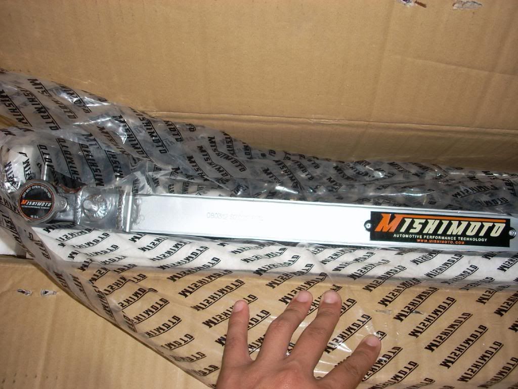

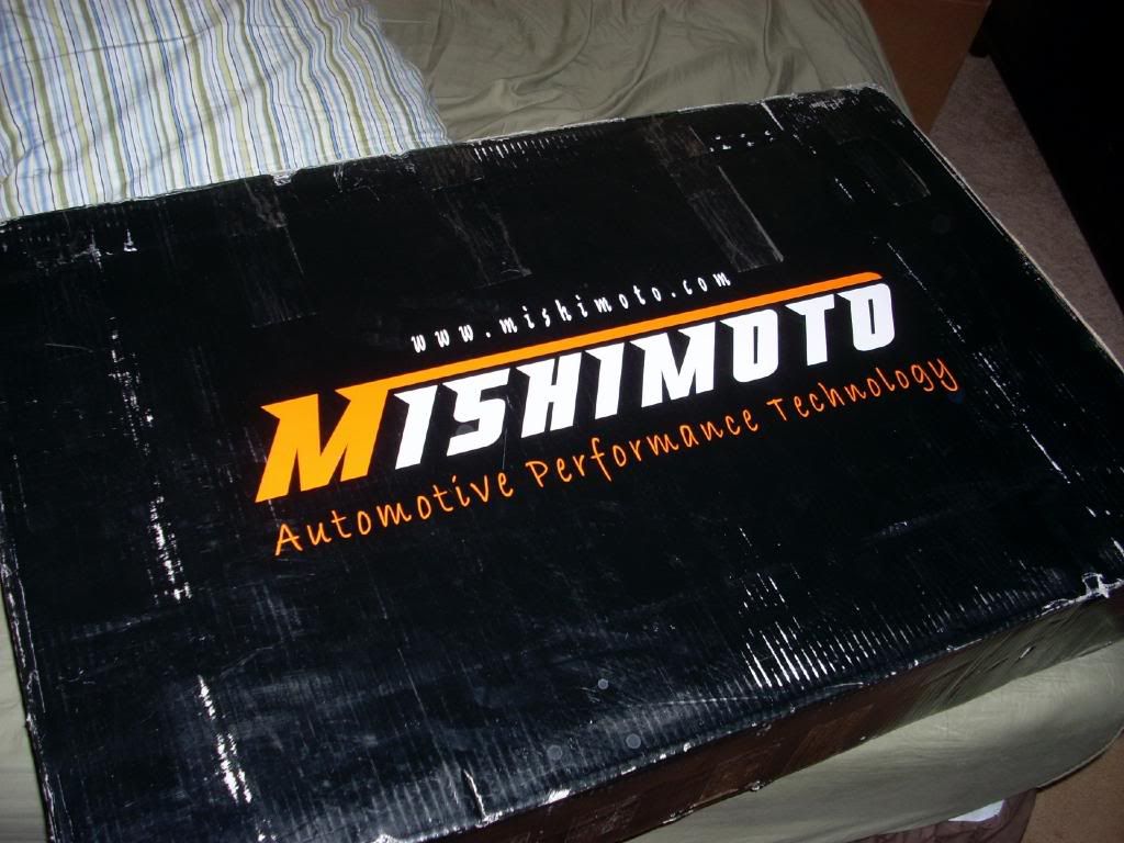

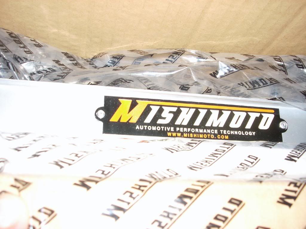

my mishimoto arrived. but waiting on the gates thermo.
ohhh yeahhhhhhhh
i got this fluid:
http://www.valvoline.com/...ct_detail.asp?product=138
the best they had at checkers!! cant wait to get the thermo already!!

Hell yeah....another mishimoto tC !
That's the fluid I got for my brakes/clutch and it works nicely

domo arigauto mr. mishimoto!!! not only does it work great it looks amazing!
